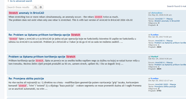

When stretching two or more rebars simultaneously, an anomaly occurs - the rebars stretch twice as much.
The problem does not exist when only one rebar is stretched. This is with last version of ArmCAD in BricsCAD 2026 v26.02

This is comnon problem in ArmCAD for BricsCAD - it is related to BricsCAD. it has already been mentioned several times on our forum
Slika
instead of the stretch command, you can just as easily use the movement of the grip points of the bar (or bars - you can also move multiple points at once)
